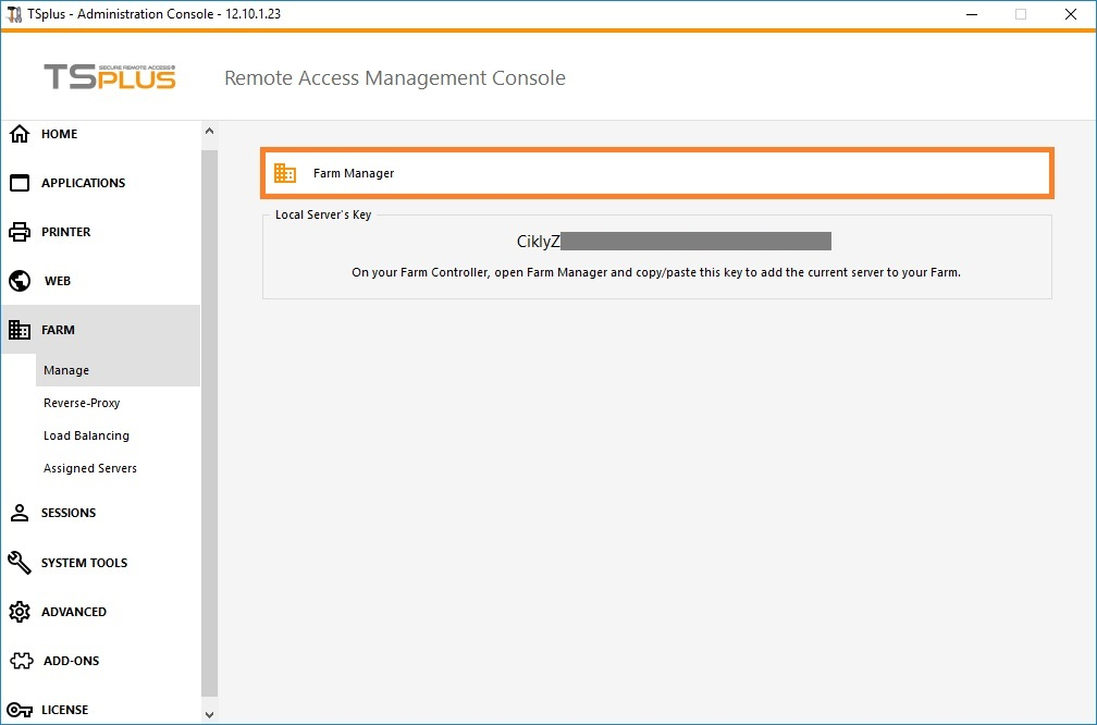

Open an Administrator session on the server which will become the Farm Controller (usually this is the "Gateway" server).
Open Terminal Service Plus AdminTool, click on the "Gateway" tab, then on "Farm Manager" as shown below:
Farm Setup 1

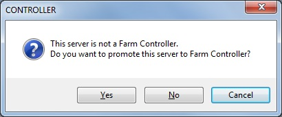

The following dialog box will be displayed:
Farm Setup 2
Click on "Yes" to promote the current Server: it will become the Controller of your Farm.

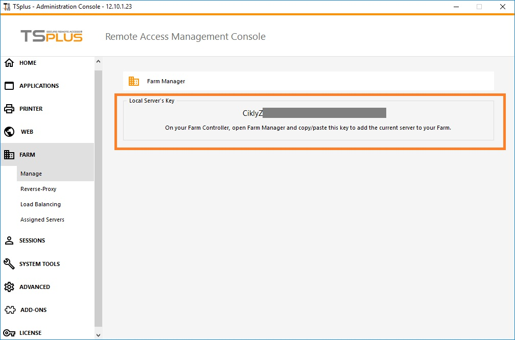

To do so, open an Administrator session on the Application Server you want to add to the Farm.
This is the server's "Key". This Key is the "password" of your server for every Terminal Service Plus farm related features. Treat this Key as a password: do not communicate it to anyone, do not display it publicly.
Farm Setup 4

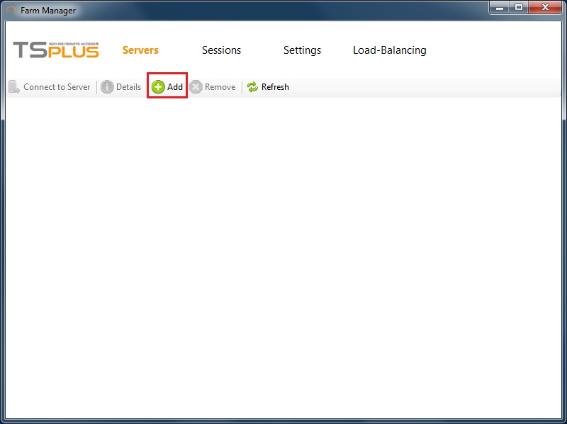

Now open an Administrator session on the Farm Controller and open the Farm Manager on it:
Farm Setup 5
On the default "Servers" tab, click on the "Add" button. The following window will be displayed:
Farm Setup 6
Enter the Application Server details, as well as the Key you retrieved just before, then click on the "Save" button to add the Application Server to the Farm.
